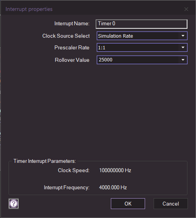

The App Developer runs on my PC as if in slow motion. What is the reason for that? This setting?
Can I somehow increase the speed?

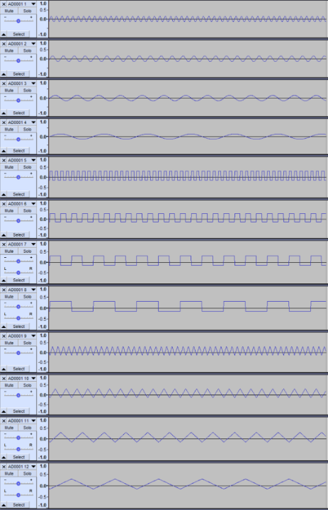

I tried to sample 12channel with 2kHz and save it on the SSD disk on my computer. The generated file AD0001.wav I can easy openthe file with audacity and its shows all the signals. The setup from the 12 DSP-Generator was different frequent and signal form (sinus square triangle)
The App is working nice but there is a speed problem. I turned of 11 from the 12 DSP generator and use just one. I added a on the end a samplecheck like samplecount/second and I have always strange results. I tried different interrupt time. I tested until 250Hz samplerate.

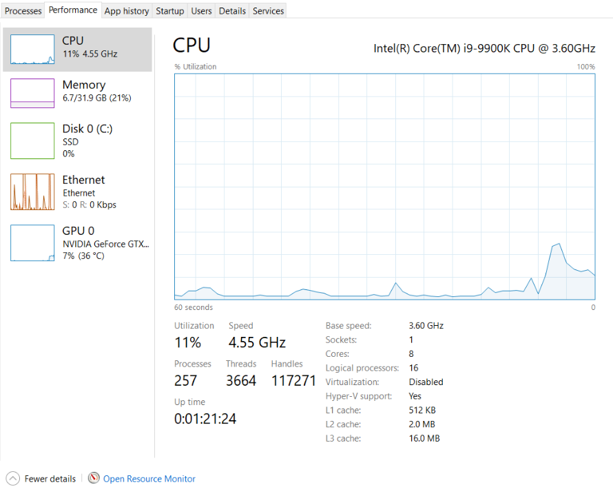

My computer is not really hard working while the app is running.
