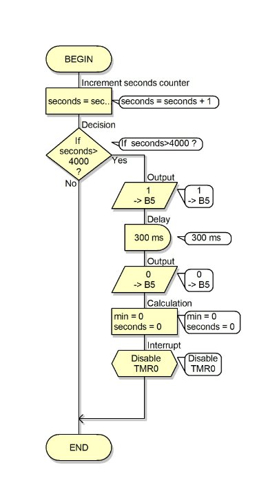

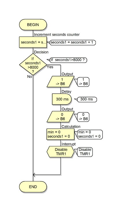

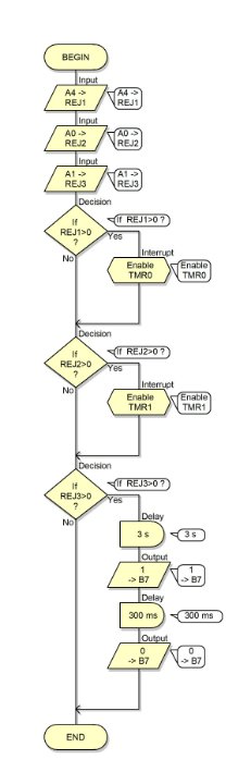

I am trying to implement a non blocking delay to power ports B5, B6 and B7 with the required delay in seconds on receiving a hi signal from input ports A4, A0 and A1. I was able to use TMR0 interrupt to create a delay for the first B5 output but whilst using TMR1 as interrupt for B6 output it is just not calling my macro.
The thing behind this is that the port B outputs must turn hi after respective seconds on receiving respective hi inputs from port A. Non blocking delay is needed because i need the program to run continously to record the inputs. Attaching my macros, the Main is only calling my REJECT macro in a while loop.
Could use some help please?

I did try using timer interrupt. I am able to work TMR0 and it calls my macro TIMERSERVICE, but in case of TMR1 it does not call my macro TIMERSERVICE2 which is linked to TMR1.

It might be missing the interrupt - you have a 300ms delay in the first macro shown (which i assume is the ISR) - this would likely cause your program to fail.
It is very hard to tell from screen shots (no macro names etc) - so please upload your code - however, as version 4 is now no longer supported I would suggest upgrading to v11 (it is free for personal use) then it will be easier to help...

So what I am trying to do with the program is:
A4, A0 and A1 are three inputs which is a high trigger signal. On receiving the signal at the appropriate ports I am trying to activate the respective port B5, B6 and B7 after a certain second delay, like say when a high is given to A4 then B5 will activate after 2s and when a high is given to A0 then B6 would get activated after 3s. But in this case, I need the delays to be non blocking since the microcontroller needs to be active to receive the input signals.
I have posted my program, any help or guidance would be highly appreciated. And yes, although not done here, I am trying to remove the delay component in the ISR but I need to know how to implement this non blocking delay?

One way to solve this is to have a timer interrupt constantly running which simply increments a global "tick" integer variable. In your main macro, have something like:
//initialise some vars
Set tick to zero
Set check1 to false
Set delay1 to an appropriate value
...etc...
Enable Timer Interrupt
Loop Forever
    //read the inputs
    IF input1 becomes high, Set var1 to tick and set check1 to true
    IF input2 becomes high, Set var2 to tick and set check2 to true
    ...etc...
    //set the outputs
    IF check1 is true AND tick > var1 + delay1, Set output1 high
    IF check2 is true AND tick > var2 + delay2, Set output2 high
    ...etc...
End Loop
Remember to use the logical-AND operator (&&) instead of "AND" or "&" in your actual code.
Hopefully this will give you a start.

ISR (Runs every Nms)
   if L1 > 0:
       L1 = L1 - 1
       IF L1 = 0 - Light led 1
   if L2 > 0
       etc
In program:
   If B1 pressed set L1 = time until L1 lit
   If B2 ....
Re: Implementing a non blocking delay

As both Steve and I mention, enable a single timer that increments a counter(s) before you enter your main loop and take all timings from that.
Timer2 can interrupt as low as 75Hz, so each second is a multiple of a count of 75.
When Pin1 triggers perhaps clear "counter1". In main loop test for counter1 = 150 and you know two seconds have elapsed. Pin2 triggering could do similar or just take note of current count and look for counter+x (where x is the period in seconds x 75).
