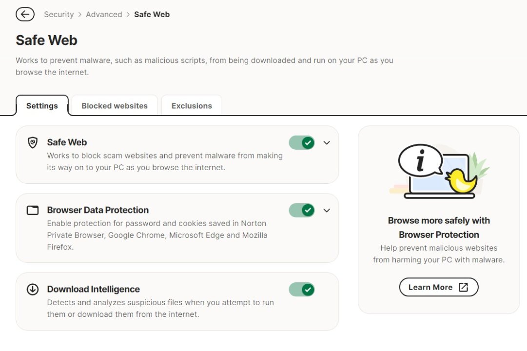

I haven't had any need, but you can whitelist from here
Screenshot 2026-01-16 095804.jpg (76.69 KiB) Viewed 4553 times
In exclusions you can specify a website you know to be safe and trust.
