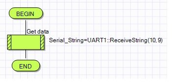

I will investigate that. Right now my interrupt consists of a single component which is supposed to get data into variable "serial_String"
It's coming back with nothing. I do know it's going in there when my characters arrive.
If I use the same component in a simple loop without interrupts, it works.

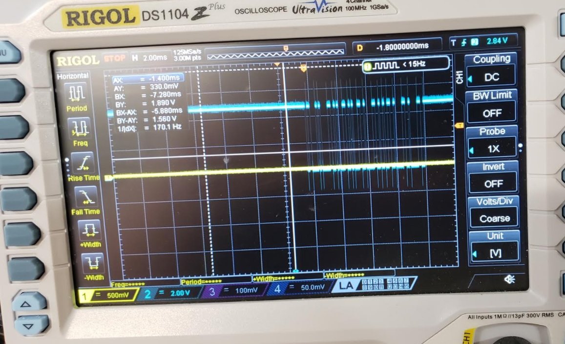

So I put the serial interrupt in, and still no info is going into the serial_string.
I put my scope on the serial input pin to the PIC24fj64GB200 with one channel on the data, and the other on the ACtive low pin for the driver.
Data is getting to the chip, and the interrupt is not working properly.
Thanks for your demo. I would speculate that the interrupt for this particular chip is not running properly.
Can someone verify this for me?
The system works well with the simulator.

for which I would suggest a very simple interrupt function where you call a single ReceiveChar() and toggle an output.
i.e. output low, ReceiveChar(), output high (aka flash a LED)
Check this occurs for each serial character with your oscilloscope.
If that works, then use ReceiveChar() to place that character into a buffer (Circular Buffer component is ideal for this)
You can also do short/simple things here such as test for a CR character, e.g. to indicate command or string received, and set a flag.
In the main loop check for the flag, when it occurs process the buffer contents.
(nb. I've not looked at your protocol to see if this is the actual method, it's just a typical scenario)
There are also ways of doing this by probing the contents of the circular buffer.
nb. Calling string receive in the interrupt is not recommended.

Actually, I have put an xor for an LED in the interrupt routine. The LED is affected by this. So I believe that the interrupt is working.
SO I think we are down to using a string in the interrupt. I don't know where the circular buffer component is, and I'm not sure if I know how to use it either.
