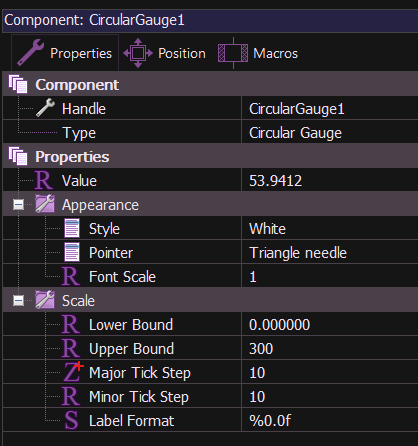

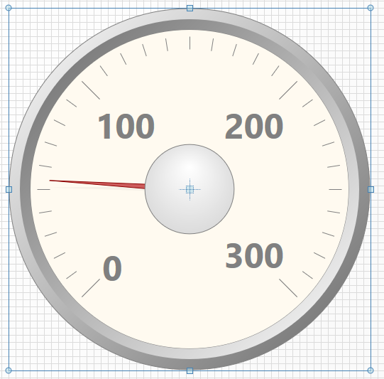

The component gauge is really nice and practical.
There are more options available in Web Developer than in PC Developer.
Would it be possible to have an additional component for PC Developer with all possible options?
PC Developer:
Web Developer:

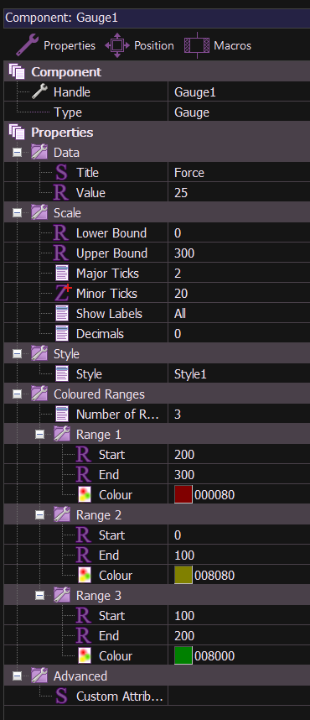

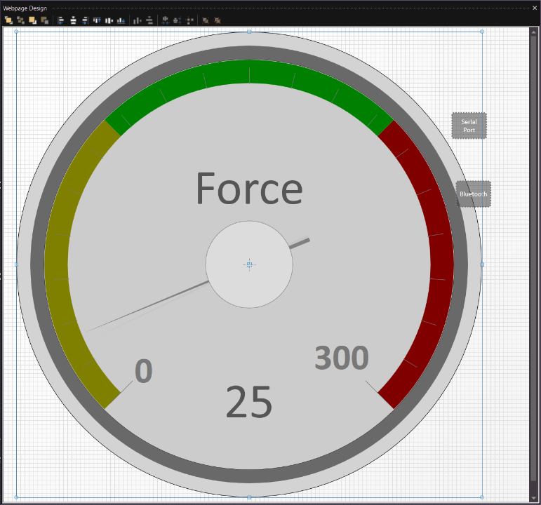

There is a hidden Gauge primitive available in Embedded and PC Developer modes which has a lot of options. This is used as the basis for the CircularGauge component (as well as a few of other components) and has many other features.
To add one, click the "Creation" component library on the menu whilst holding down the control key. You will now see a "Gauge" component there under "Primitives (2d)". Drag to add to your panel and you should have a load more additional options available.
This is an advanced feature and I would only recommend it gets used by experienced users (which is why it is a bit hidden).
For example, here's one that's heavily customised:
