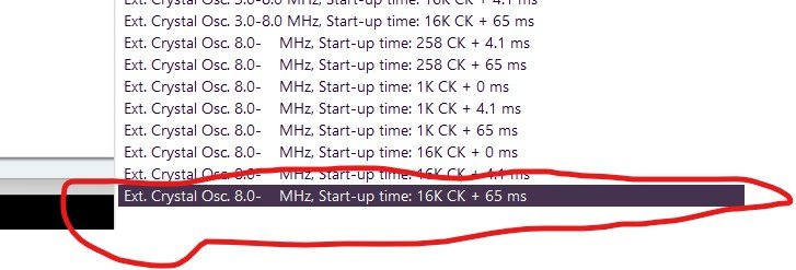

I'm not overly familiar with ATmega but it looks like you will need to:-
Step-4 Project Options set Clock Speed to 16MHz as this tells Flowcode what speed you are running. Very important to set correctly.
Step-5 Chip Configuration. I would choose last option as this is for 8MHz and above (as far as I am aware). You may get away with a lower than 65ms startup time depending on your crystal, but this may be safest option to start with
Screenshot 2026-02-14 133129.jpg (43.22 KiB) Viewed 2483 times
To check, run a one-second flasher.
