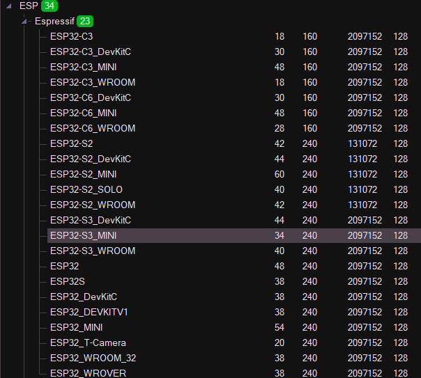

Would it be possible to add an ESP32s3 mini-1 as a target?
It has more pins.

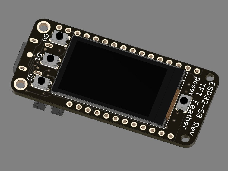

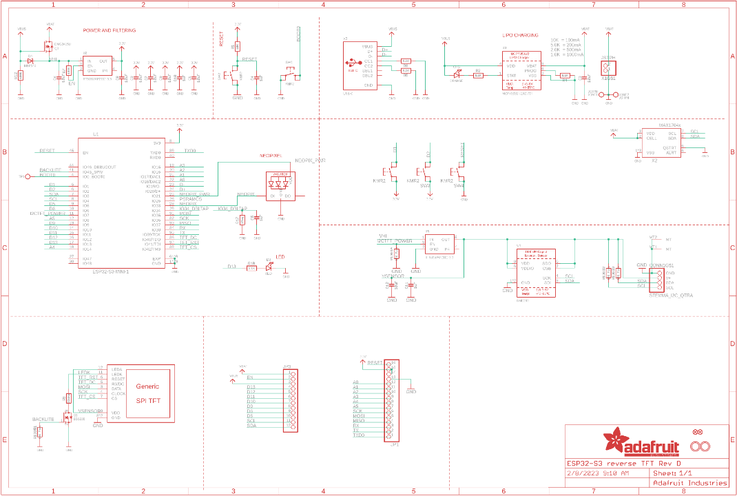

Current selection from FC11 ESP32s3 mini does not have all the necessary ports and pins:
This is, for example, on the
Adafruit ESP32-S3 Reverse TFT Feather
5691 ESP32 S3 Reverse TFT Feather.jpg (68.5 KiB) Viewed 10142 times
https://learn.adafruit.com/esp32-s3-re ... t-feather

Hi Stefan,
Great spot thanks for letting us know, should be sorted for you now.

Perfect!
I was able to connect all the pins and it works in the simulation.

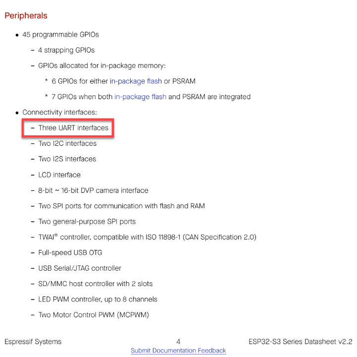

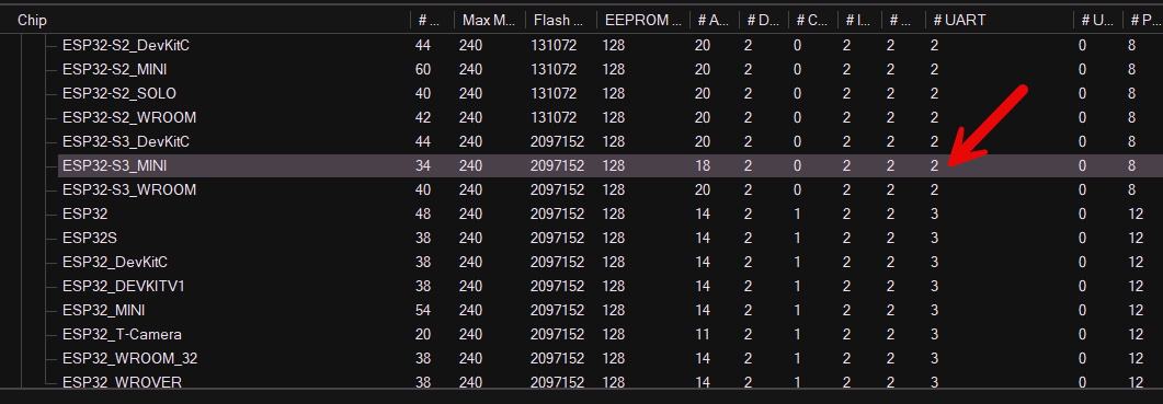

One more question.
The ESP32S3 Mini has 3 UARTs.
Can you add the third one?

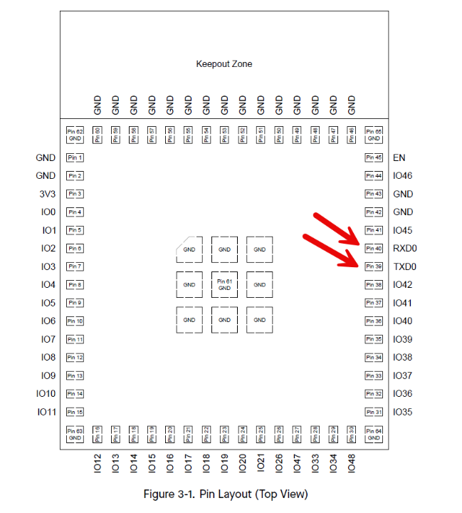

Here's another small issue
For me, the most important thing is that UART0 is mapped to GPIO 43 (TX) and GPIO 44 (RX).
Maybe it's just a graphics issue with the PIN number:

Various components use UART for communication, such as GPS/GNSS components.
The ESP32S3 has the major advantage of having three UARTs.
You can choose the pins for two of them, while one is assigned to a fixed pin.
However, Flowcode currently only supports 2
Would it be possible to add a third one?
