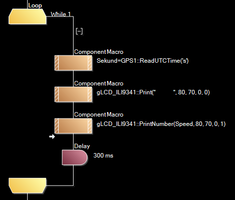

Can you check your program if you read sekund and display speed?
And which pin did you use from the ESP32?

Thank´s for reply. Yes you have rigth concerning the Speed and second. I have change it so the return now is Second ;)

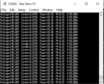

I'm currently using an ESP32 Lolin to receive data from a PZEM-004T via Modbus and I have the ESP32 sending the data via UART to Tera term:
I'm assuming as the Modbus is working then I/P and O/P of UART is working.
Plus I have an additional UART output working.
So rather than FC UART component, could be a FC GPS component issue?
