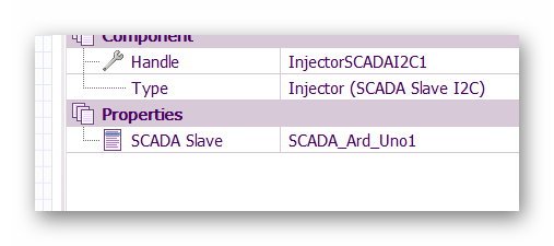

I'd like to create a component where if a Scada slave is added by the user it can be used in Scada mode.
I can do this 'as source' where the SCADA slave can be added to the injector component - and this works well in simulation.
But I'd like to 'expose' this to the top level, so that I can export as a component and give the user the option to add the SCADA slave of their choice (rather than including the Arduino SCADA or whatever..)
This I (try to) do by clicking 'expose to top level' - however the variable has no options and 'clicking' on it resets the underlying value to null.
I assume I need to populate the list of components offered to the user - but not sure which events are needed to do this?

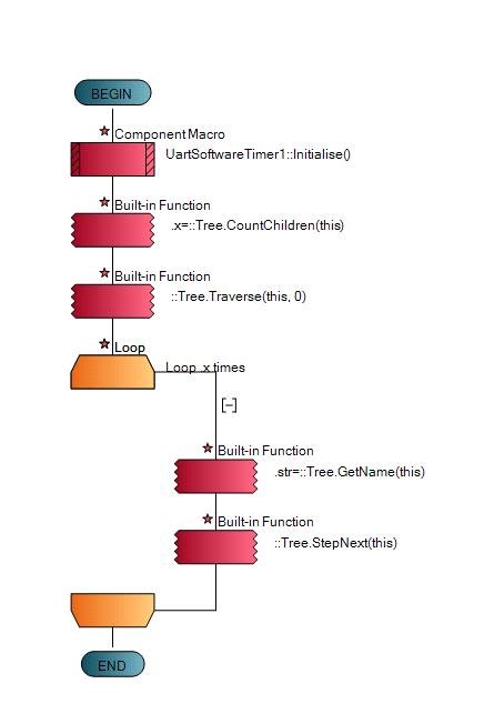

Hmm, it's tricky..
I think I've managed to 'pull' the components using:
Which when stepped through sets main.str to each component's name. Next - can I attach this to the drop down menu ???
Software timer is just there as a test component (also had a couple more added to the project...)

I'm not sure if this is currently possible. I tried to do something similar for the network comms component and found the same problems. Which is why we have the visible network comms layer in our programs.
The Injector to SCADA Slave property uses the Panel Object property type and this only seems to go one level up from the component source.
This works
Panel
-Injector
-Scada Slave
This doesn't work
Panel
-Component
--Injector
-Scada Slave
We can maybe look into this or change the way that injectors point to their host component to allow for this mapping. The way the comms components hooks to an injector component is a bit more intelligent and this method might work.

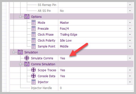

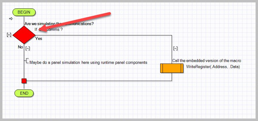

Not necessarily The Switch for COMMS Simulation is part of the panel properties in the template,so when you export the component these panel properties are part of the Component properties and
for each HW embedded macro you have you create a Sim macro with the Swich statement to detect if COMMS Sim is YES OR NO if yes it execute the one part of the if statement which you do a call to the HW macro and the NO side you do a panel simulation if you want.
so if you have a CAL component as part of the Componet then when the component is exported and the user load it for a PIC FC will load the CAL componet for PIC if another user load a STM the Flowcode will load the CAL for STM
So for example you have embedded macro Sendbyte() which send a byte over the SPI CAL then you make a SendByteSim() in the YES part of the Switch or if statement you call the macro Sendbyte so now when you simulate and COMMS is set to yes then the Sendbyte HW macro is called and put threw the injector to SCADA if NO then it will not call it but you can then do some simulation on the panel
in the interface tab of the Export component properties you set Sendbyte as Downloadable and its simulation macro as Hidden macro
so when your user program his chip the Sendbyte () macro is in embedded code if he runs simulation with COMMS set to YES then FC call the SendByteSim macro and execute the HW SendByte macro but threw the SCADA injector , This is all mcu independent . the suer selcet the mcu he uses and FC will call the correct CAL file for the mcu he is using,
Hope I could explain it somehow
