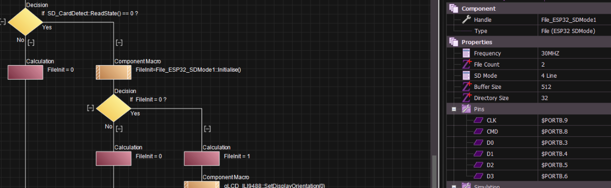

As I say we have it working great on the ESP32S3 so not sure wehat the problem is here.
This is my firmware project file and the part that initialises the card. We are sure the card is running as we put bitmaps and font data onto the card and that's all working great.
Screenshot 2026-06-19 104019.png (127.24 KiB) Viewed 5821 times

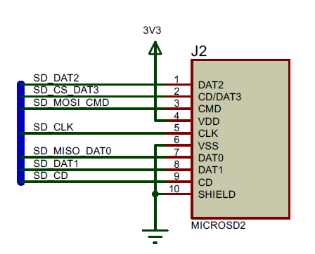

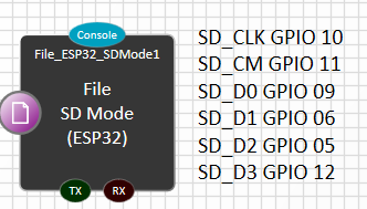

I've checked everything on the board,
and it's all fine.
Do I still need to include any files?

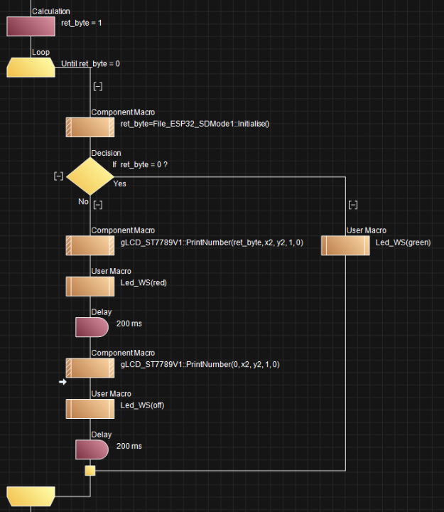

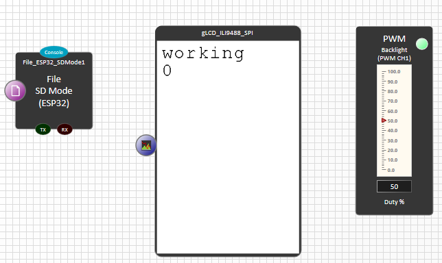

I created a small test program.
It works in the simulation, but in hardware it never exits the loop.
