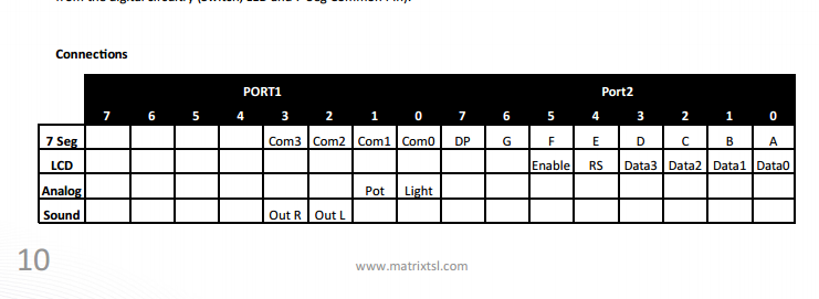

As you are using the 16F18877, it is set up to work at 32MHz internal osc with no additional c code.
The issue looks like its with your hardware port selection.
If you look at page 10 of the Eblocks2 datasheet it shows the connections for the display is on port 2.
BL0114 Connections.png (42.56 KiB) Viewed 4517 times
You have port 2 (what LCD is connected to) of BL0114 set to D.
If you connect port 2 (same side as the pot) to port D of the BL0011 then port 1 of BL0114 is not physically connected to anything, its left hanging in mid air!
On you project you have set it to Port A .
To connect Port 1 to A and Port 2 to D is impossible.
You need to change Port 2 of BL0114 to port B which is the intended port.
Then recompile.
