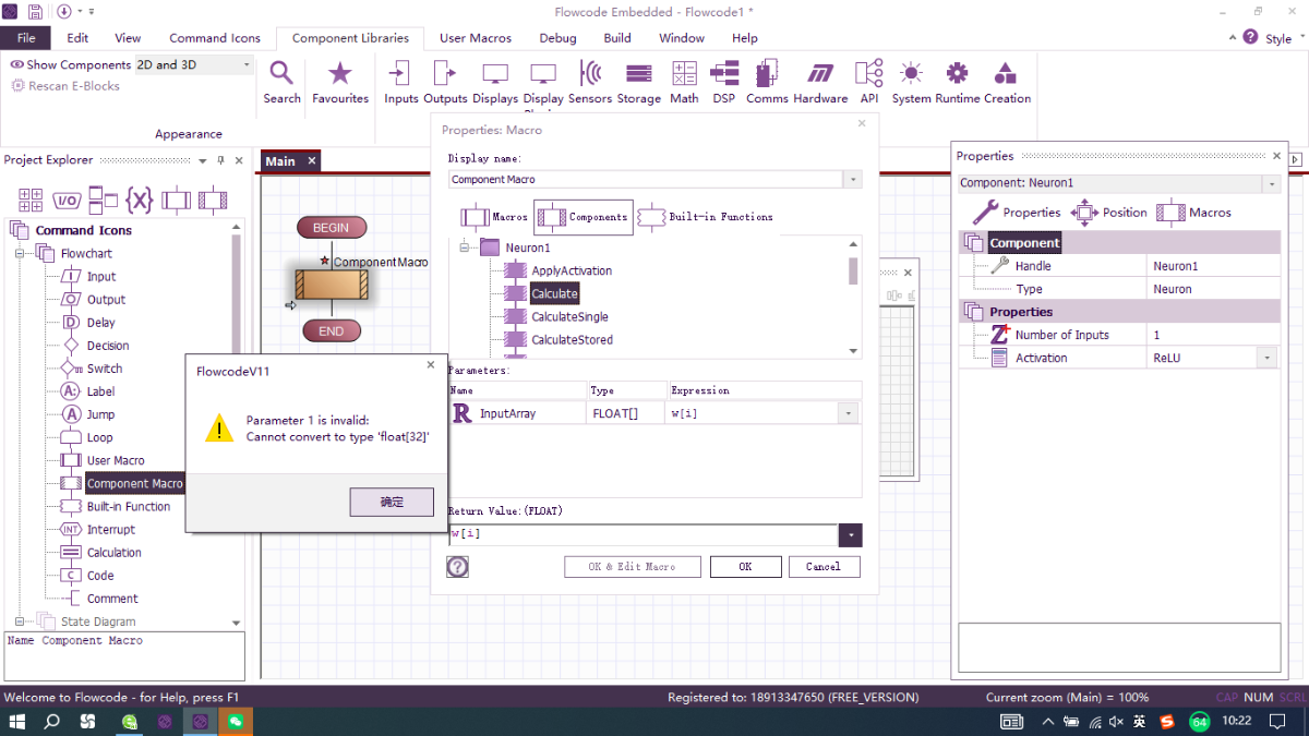

Re: Embedded AI
Posted: Sun Jul 26, 2026 3:28 am
by 17712885438
There is an error in the macro command.
