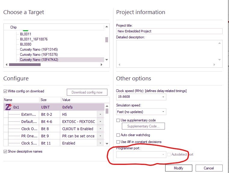

How can I connect my Curiosity Nano PIC 18F47K42 device? When I connect it via USB, it doesn't appear in the programming port list. I also want to use it for debugging. I tried with Pickit 5 as well, but it didn't work. I would appreciate your help.

The board is supported in Flowcode v11. Does Flowcode offer a programming port option to select for it (Build > Project Options) ?
Screenshot 2026-10-04 093434.jpg (71.25 KiB) Viewed 18 times
If not then your PC isn't recognising it. Any yellow exclamation marks under Device Manager or the like?
