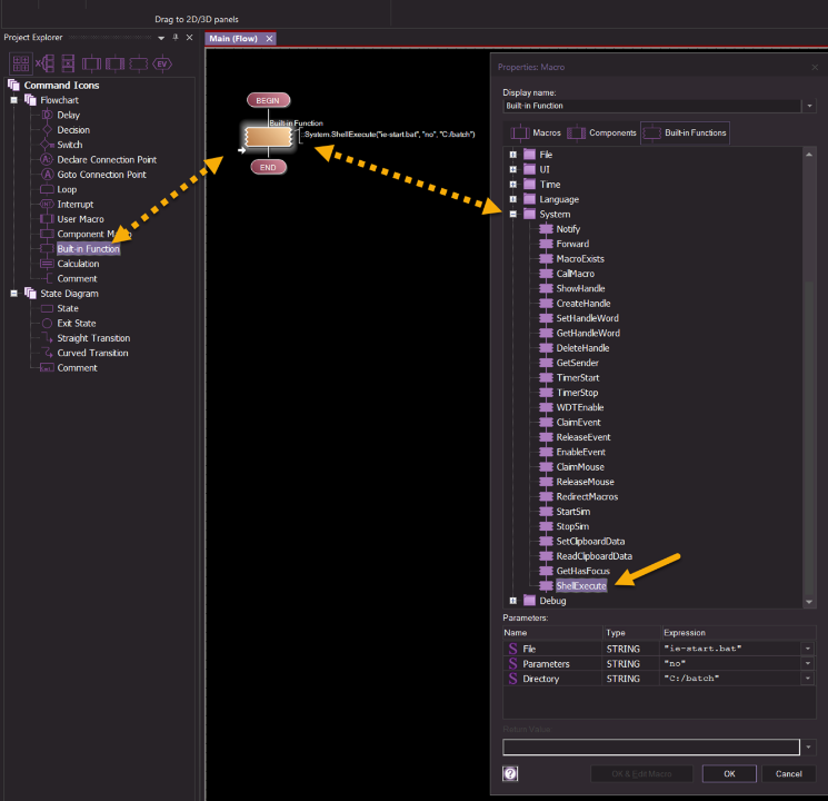

Is there also an info about:
ShellExecute - allows external files, websites, etc., to be launched
SerialDLL - GetCOMDetails added so components can report details and make decisions on the connected hardware

The info on the wiki is being updated and will hopefully include the new additions in v9.1 soon. The ShellExecute function should behave like the internal Windows function and there are many references online that should help you use it before the wiki is updated.

Perfect. I found the shell and it's working nice.
