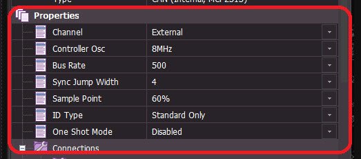

2. I have checked the timing and can confidentially say that I believe that my initial assessment of a potential bug is now stronger
the hardware checked out all good the scope measurements as well this is only true if I insert a bit of hack code that was put to together
based on various bits of research and sources and diving in deep flow code insides
It is my conclusion that the settings shown in the red block is some how not sent or sent incorrectly to the external component or omitted
during compiling suspect it is closer to the front end of things because if I include the code in the green block inside of a
custom c-code icon the CAN bus comes to life and operate I have the same story when it comes to the processors main clock which i have
to include the code in the second green block that I have had to do sins I started with flow code and got use to it, I also noted that 16Mhz
is not on the Can OSC list
could this be a bug, my platforms configuration or operators error, if I am not mistaken it is suppose to be that the settings is entered in
the prosperity block and that's it for the configuration

Re: External CAN BUS component suspect
Posted: Mon May 24, 2021 11:26 am
by p.erasmus
HI,
The MPC 2515 is fitted with a 16 MHz crystal as i am using a can bus shield see the pdf zip for precise config data
Just one question in your first post you metioned that you are using a 16Mhz clock to the MCP2515
if this is the case then the OSC setting in the MCP2515 component is incorrect (8Mhz)

1) CheckRx() only returns 0 or 1
2) The CAN component only supports 8MHz or 20MHz options,
so the properties set for an Osc of 8MHz will not give the expected CAN bus rate when the hardware is using 16MHz
(You could try setting a bus rate of 250 @ 8Mhz, which would give 500 @ 16MHz)

As long as the FC component Clock setting and the HW clock does not correspond the component will result in Baudrate Errors.
I would change the HW Clock(XT) to the MCP2515 to a 8 or 20Mhz,I always use 20Mhz it give a good operation speed
It would be great if Matrix add the 16Mhz setting because many HW boards supports 16Mhz :D
