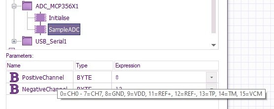

I've now created a component for you and tried to keep it as simple as possible with just an initialise and sample macros. It may be too simple and you may want some of the more advanced features of the device, if this is the case then let us know the specifics of what you need. I can also share the component source project if you want to be more in control of what's available.
The sample macro allows you to to specify the positive channel and negative channel so you can use the ADC in differential mode or you can lock one of the channels to VDD/GND for independent inputs.
Let us know how you're getting on.

if i set the positive and negative channels to analogue ground, or both to the same ground, the output value should actually be around 0, i think.
the same if i set the selection to 0 and 1 and short circuit the inputs.
is always
16777215<CR><LF>
16776959<CR><LF>
16776703<CR><LF>
16776959<CR><LF>
16776959<CR><LF>
16776703<CR><LF>
16776703<CR><LF>
16777215<CR><LF>
8 and 12 results in
<CR><LF>
16777215<CR><LF>
255<CR><LF>
255<CR><LF>
511<CR><LF>
511<CR><LF>
16777215<CR><LF>
255<CR><LF>
255<CR><LF>
255<CR><LF>
511<CR><LF>
511<CR><LF>
511<CR><LF>
511<CR><LF>
511<CR><LF>
255<CR><LF>
511<CR><LF>
511<CR><LF>
255<CR><LF>
511<CR><LF>
255<CR><LF>
255<CR><LF>
255<CR><LF>
511<CR><LF>
255<CR><LF>
16777215<CR><LF>
please check once

In your program you are sampling between 8 and 12 which equates to GND and REF-. Hopefully this is all that is wrong.
I'm not sure what is suppost to happen here. It could be you are suppost to get 0 but I can't say for sure. What happens if you select a valid ADC input channel for the positive and GND or VREF- as the negative?

the positive reference is 2048 millivolts.
if i switch the positive channel to 11 and the negative to 8 or 12 the ADC should output a value of +8388608. that is 2^23. as the ADC has no negative reference. REF- is equal to GND or 0.
The ADC always converts the difference of the two inputs.
The board can only output +8388608 or -8388608 at gain 1 because there is no -Ref voltage of 2048 millivolts.
If the difference of the input voltage is 0, 0 must also be output. This means that without voltage at the inputs the output value is 0 and this should be the case if both channels are equal, e.g. both at 8 or both at 0 or at 0 and 1 without voltage with a short circuit.
