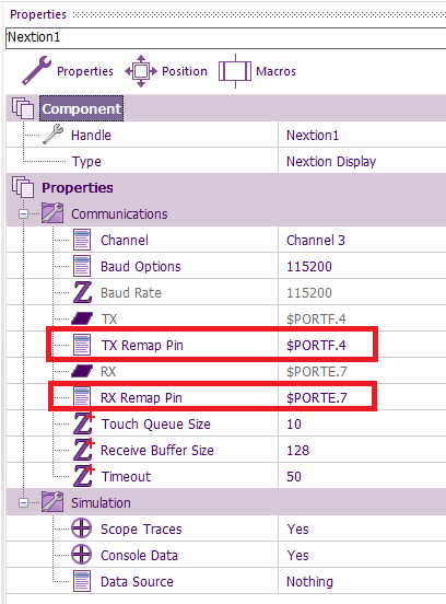

Tried Nextion display on BL0032
Software channel does not appear in channel selection drop down in Properties window
TX and RX pin selections are grayed out so cannot set to any port pins
Can you check and revert
David

Can you try this update please?
In file explorer address bar, paste this:
C:\ProgramData\MatrixTSL\FlowcodeV9\Components
Extract the component within the attached zip file and save it into the above hidden folder.
Just select ok to replace the current file.
If you got Flowcode loaded when file was placed in the components directory, you must select the reload icon before compiling again.
If the update works ok, I will arrange for it to be add to the update system.

Hi David,
Working well for me here using Medelecs fix. Do you have the TX and RX remap pin properties?
No software mode available I'm afraid as we are using the hardware receive interrupt inside the component to collect replies and touch data.

Hi Medelec / Ben
Installed the updated file and can now select port pins fine
And Ben i note your comment re no software mode available makes sense
Many thanks for your joint prompt replies
