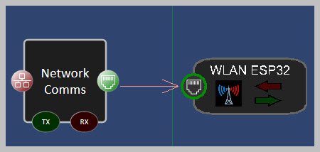

I was looking in the wiki at the ESP WLAN component for a simple example it seems there is not an example.
I would like to set the ESP up as a server (not web server)and connect the Wifi to a Labview client(TCP) program over wifi on the local network
I am not sure if I should use the network componet plus the Wlan component ,
I noticed that both network component and Wlan component can open and close and read /write to a socket sorry for my ignorance but can you guys
help to understand what I need in components and get it connected to the Router and open a socket and wait for requests from client .
when to use Network component plus Wlan component and when to use only Wlan component is another confusion for me :oops:

Hi Peter,
Sounds like a nice project, sorry for the delay I've been away on holiday this week.
Yes the ESP should be able to do this and hopefully we can provide you an example.
The ESP component provides it's own API so you can call the commands for this component directly.
The Network Comms component provides a general purpose API and so it works with multiple hardware specific targets such as the ESP. Therefore it adds a layer making it slightly less efficient but allowing you to move between hardware platforms and also allowing for library support such as the BBC weather, MQTT, Webserver or Modbus TCP etc.
I'll see if I can put together a server example for you.
