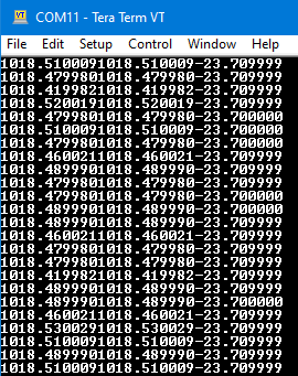

Your flowchart is working for me:
Pressure & Temp.png (16.35 KiB) Viewed 17642 times
Can you try the attached sniffer, my results for the BME shows:
Sniffer - BMP280.png (1.95 KiB) Viewed 17642 times
Perhaps the Ardunio is not seeing your device, or the address is incorrect?
