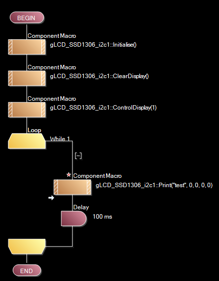

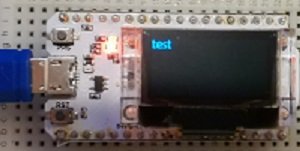

Re: OLED SSD1306 I2C Address
Posted: Thu Sep 30, 2021 9:18 am
by medelec35
I'm using a wifi kit32 which has a SSD1306.
I can confirm your flowchart working for my display using 0x78.
The only things I changed was the pins as my display is built in to the ESP32.
The Baud Select from 100k to 400k as 100k is way too slow.
Interlaced to yes otherwise will cause the display to look wrong.
The font to Calibri 14 since interlaced will make the default font fairly small.
Have you tried a 1 second flash test?
