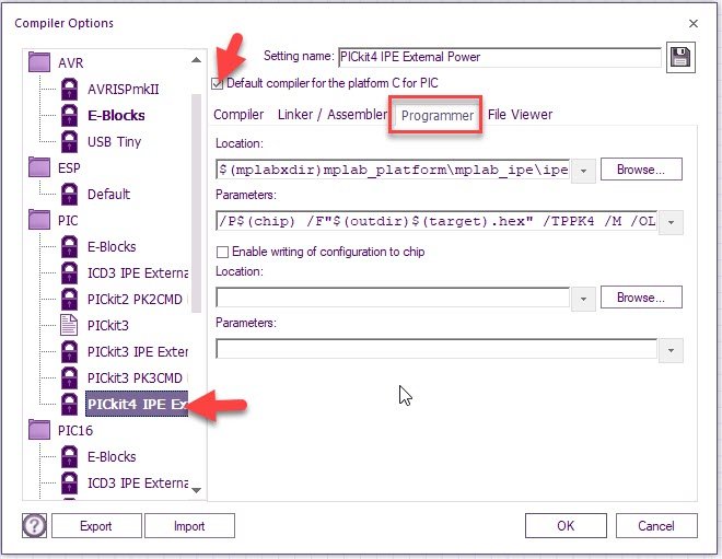

You should be able to select the PicKit4 as a standard option in V9 as you will see below,Note you have to select the check mark set as default.
Another issue could be if you use an MPLAB verion pre-5.30 then the ipe is not in mplab_platform folder you need to search for it then I am not sure where it was located pre 5.30 version it a long time ago.
