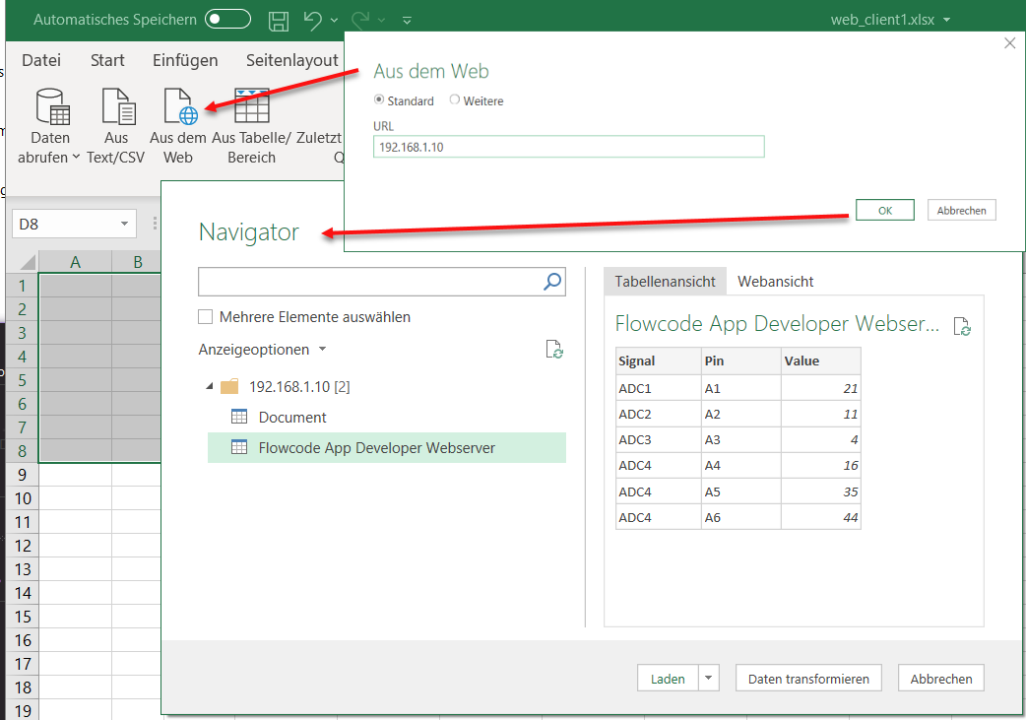

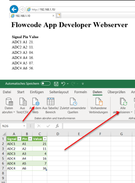

I changed it a little and took the date and time as simulated AD values. I wrote these values in an HTML table. I can look at this table in Explorer and also automatically insert and refresh this table in Excel. I just have to enter the IP address. I would now like to read and process this table with the app developper. How can I do that?

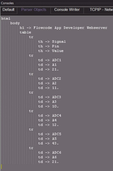

This might work with the XML parser.
Let me have a play as that would potentially save you writing a finite state machine to parse through the raw text.
You could always format as XML on the server end and this might make things easier but then it probably wouldn't be as nice to look at if you need it to be presented in a table.
Re: App Developper: From Webserver to App Developper
Posted: Fri Nov 05, 2021 11:59 am
by BenR

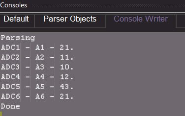

Yes it does work as is with the XML parser. HTML and XML are very similar.
Here's a simple example to parse the data string and print data to the console.
XML_Example.fcsx
(15.36 KiB) Downloaded 746 times
You would just need to combine this with the example with the GET request and then you will be able to collect the data string from the server and parse through the data table.

Thanks a lot for the example. I put both together and it looks like it works,
but not enough characters are received. One times it will be 179 or then 19 or 79 or 139. I tried to make all the arrays bigger but without success.
Web_Get_From_Server.fcsx
(21.34 KiB) Downloaded 788 times

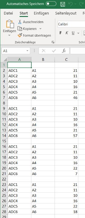

I add the CSV writer and It is very convenient to save an Excel file on the PC with the data from a Flowcode web server
Web_Get_From_Server_csv.fcsx
(24.16 KiB) Downloaded 803 times
parsing to excel_2021-11-10_16-25-05.jpg (42.04 KiB) Viewed 9926 times
