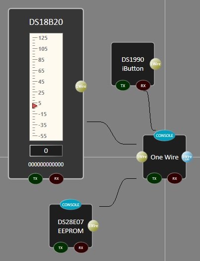

The DS18B20 component requires the OneWire component which hosts the bus and has the pin connection properties you're looking for. The OneWire component is available under Comms -> Comms: Interface.
It's been done like this to allow for multiple different types of device to be hooked onto a single OneWire bus and to keep things as simple and efficient as possible.
For example.

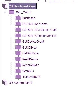

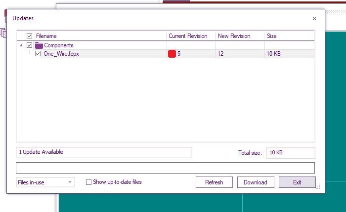

If you just add the onewire component and down grade it to version 5 that might solve your problem.
Version 5 has DS18B20 commands built into it.
Its worth a try.
Or I think maybe the onewire component is not in the version you have. You might be stuck then.
Mark
