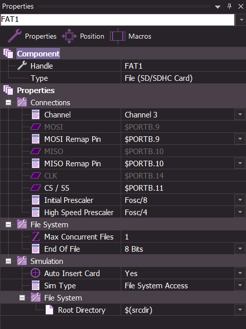

Hi. I've been battling with a sd card read write for a while now. The flowcode below has stripped out of a bigger project to try and figure out why it doesnt work in hardware but simulates. Its messy but thats because ive been stripping things out adding things etc. Can you give me apointer? The circuit also uses an RTC which is working and I have spent quite a while figuring out which PIC to use, settling onPIC16F1887 for its ram size and features. Any help pointers greatly appreciated. Flowcode has greatly improved development speed up to now but I need your help now

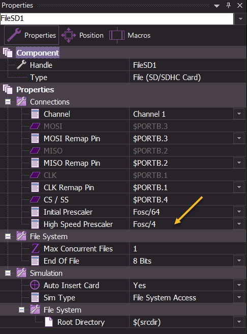

Set the Speed Prescaler to 64

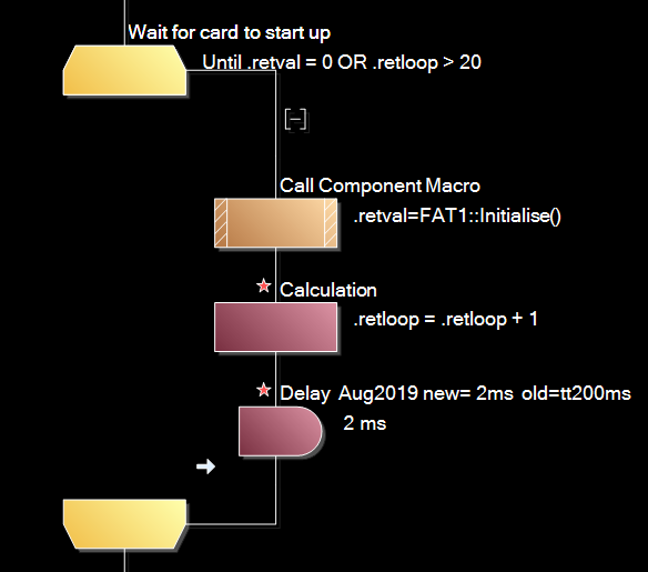

Try to make a loop like this (name is fileSD ):

I tried as you suggested. Changed high speed prescaler value to 64 and made some changes to see what was being returned. So from the flowcode it displays 255 continuously as i wanted to give it as much time to initialise but to no avail

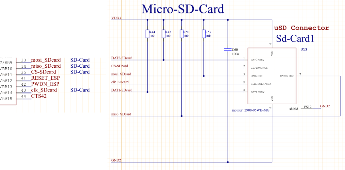

Here is my hardware as a sample how to connect a micro sd card to a PIC and set the port in FC.

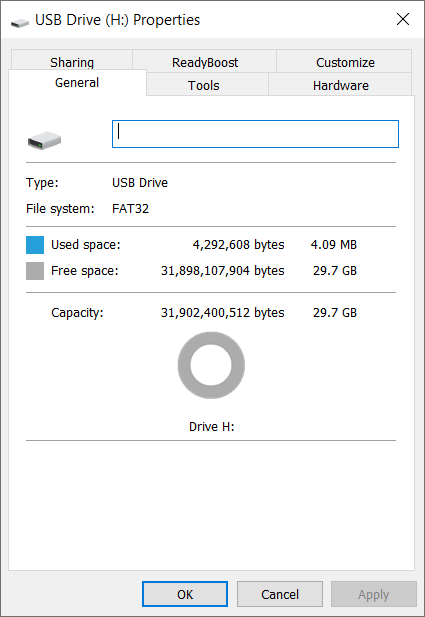

Can you check if your SD card is FAT32 format (Windos click on drive and choose propertis)
