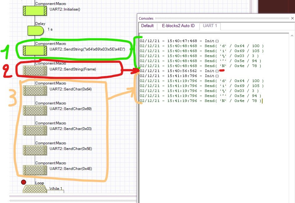

I did different test
1- SendString like you proposed to me:
Data are well send in simulation but can not compile program , Failed attached log file
2- I don't know if data are sent to UART and there is no data in console, is it normal ?
3- Data sent and can be compiled
Could you check point 1 and 2 please

Re: Way to send data from UART
Posted: Thu Dec 02, 2021 3:32 pm
by LeighM
re your first post - you need to remove the final \ character in send string
re second post - I don't see any errors, the compile and flash to device looks like it all worked ok
There are quite a few warnings, but these are normal (for now) and can be ignored.
Posted: Thu Dec 02, 2021 3:59 pm
by Xbiotec
Yes you are right !
Yes without final \ character in send string, no error.
