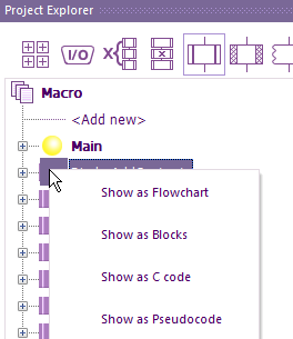

You can right-select the user macros and view the following:
View Code Options.png (11 KiB) Viewed 1822 times
THere is also View C code for the whole project within Build ribbon, View C Code
