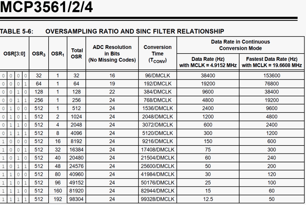

According to the specified range, the MCP356X should manage an OV of 2048 at 10SPS. see list 1024 is still running

For example, if I want to use the possibility of oversambling, which the chip can do without further ado,

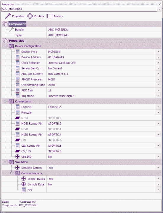

see the excerpt from the data sheet, in the properties of the library, I get stuck in the query of the input values from the chip. When I look at the transfers on the SPI lines, there are a lot of transfers or queries. I think that the chip is constantly being queried by the library to see if there is new data. Since I want to have a new value 10 times a second or even faster, the library is triggered again before it has determined that the chip is providing new data, the software hangs.

I have attached 2 programmes in the post with the name ADC 9 Click BEN_1 makes the image Ben1.PNG

Ben_1 reads a value every 501 msec with 2048 oversampling ratio
