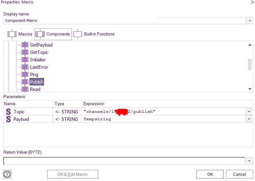

But where do I need to enter the write key? The "topic"?

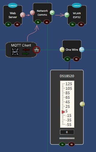

The setup I have right now is this:
So I guess that now it's as simple as publishing a topic and payload?
Does anyone have a working example for me to investigate?.

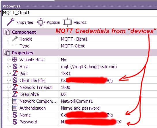

And using these settings:
I still don't see the data I send appear on Thingspeak..
Am I using the right credentials?
Any help is welcome..
