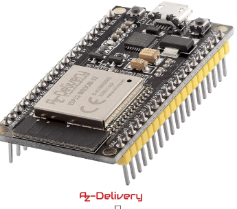

I have a big problem with the programming of the bluetooth part of the ESP32 complete with programmer see image:

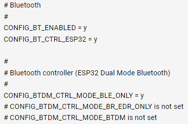

I regularly program a led flash but I can't program the bluetooth part. I also modified the "sdkconfig" file as indicated in the forum but it doesn't work; many times when I rebuild it overwrites my changes and it never worked. see image:
my "sdkconfig" file generated by flocode9 is the following:
I am desperate, I have been reading in the forum for many days and doing tests but always without success.

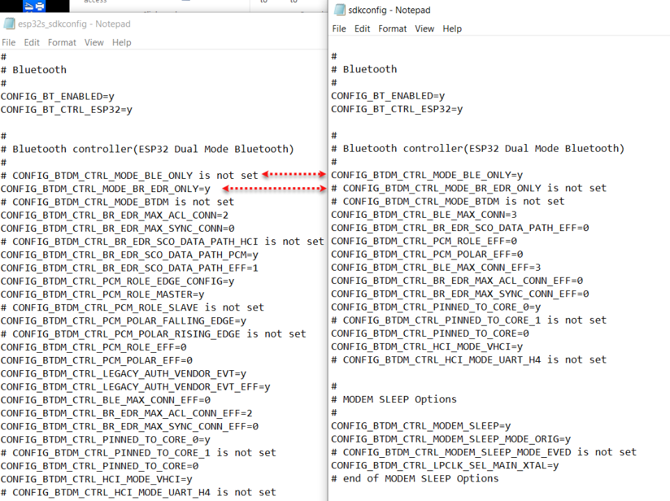

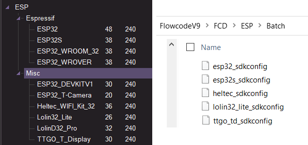

Please can you try editing the sdkconfig file for your target board here.
C:\ProgramData\MatrixTSL\FlowcodeV9\FCD\ESP\Batch
Copy and paste the address into your file explorer to get there. This should be the master file that is used to define your projects.

That would be great if that worked.
The way it looks I would only have to change the ESP32S and then the ESP32_ROOM_32 and ESP32_WROVER would also be changed?

Sorry BenR and Leigh, I am not a programmer, I am a hardware engineer, I have some difficulties following you, you have to have a little patience, for me it is not too clear, I have upgraded to flowcode9 only for the esp32 tool, I want to be able to do it work.
1 I use an esp Wroom 32 "Az Delivery", the one shown in the figure.
2 espwrom32 does not have its own dedicated "sdkconfig" file, do I have to modify "esp32s_sdkconfg" as suggested by Stefan.erni? or should I modify the sdkconfig file created inside the project folder? which items should I change, the two files are very different.

by BenR
Yes you can modify the esp32s_sdkconfig config file for this one.
The last part of this line in the compiler output shows you the config file being loaded.
Launching the compiler...
C:\ProgramData\MatrixTSL\FlowcodeV9\FCD\ESP\Batch\esp32_build.bat  "D:\Dev\FlowcodeV9\Compilers\esp-idf\\" "test" "C:\Users\BenR\Desktop\" esp32s_sdkconfig

by stefan.erni

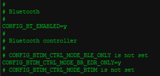

If you have a modify esp32s_sdkconfig file can you post it as esp32s_sdkconfig.txt and so we can remove the txt and copy your file in the batch folder.
I also have some problem to edit this file.

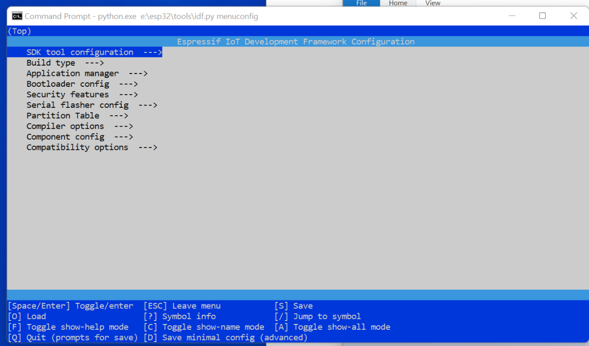

Running idf.py menuconfig... After a bit of fiddling.
Open a command prompt (Windows cmd) and navigate to the folder containing the sdkconfig file (cd save folder\projectname) where save folder is where you saved the flowcode project to and project name is the actual 'name'
type "esp folder\export.bat" enter and if all is well.... You'll know!
idf.py menuconfig
Where esp folder is where the esp tool are saved in my case e:\esp32 (usually esp-idf but I had much difficulty getting it to work...)
There are a LOT of options!

Posted: Wed Jan 05, 2022 9:48 pm

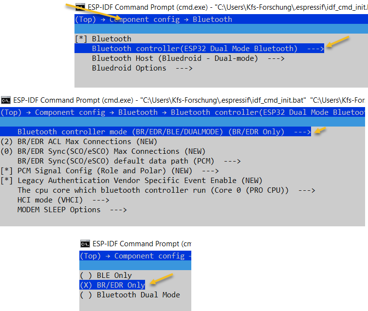

by stefan.erni
Hi to All
With the idf.py menuconfig I chanched the sdkconfig in the projectfolder and BT is working fine.
I also chanched the esp32s_sdkconfig in the batch folder and create a new project, but again BLE_ONLY is set.
I removed the esp32s_sdkconfig from the batch folder so there was an error for the new project, It's mean I was on the right file.
I have no idea where the problem is....
