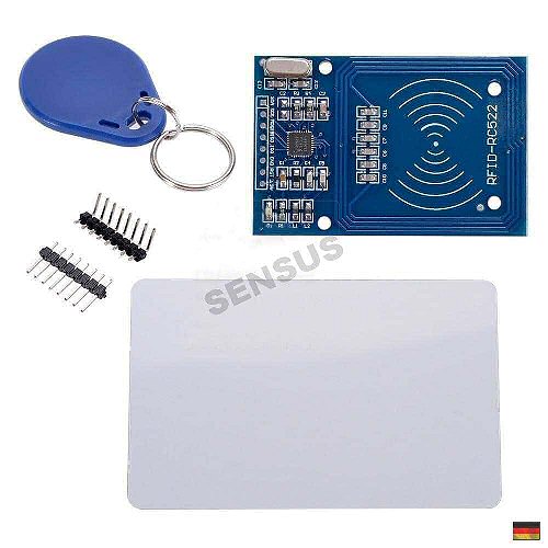

I use the Mifare NFC card reader module.
Mifare NFC card reader.jpg (36.44 KiB) Viewed 4216 times
Does anyone have some good tips or a working process? Of course, I would also like to save data to the Tag and then read it out again for verification.
