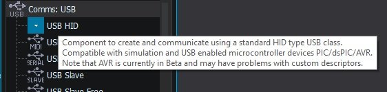

Re: PIC32MX + USB HID + CAN Doesn't Compile
Thanks and glad you're up and running with a different device. The PIC32 is not currently supporting the USB components as detailed in the component tooltip.
I'll see if this is something we can add soon.
