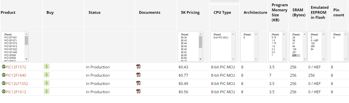

This PIC has very little ram maybe you can switch to one with 256 byte
Here a link to the 8pin 8bit PIC.
https://www.microchip.com/ParamChartSea ... nchID=1001
stefan

Re: Programming warnings & memory usage
Thanks.
I only picked that one as it had 4 PWM outputs in a 8 pin package so my choices were a bit limited.
Still curious as to why I can use 127% of the available data space.
Ben
