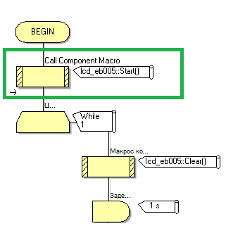

Hello! Thanks for the example. Please indicate an error in the attached file. It is necessary to reflect the value of the variable(var) on the indicator. Thanks in advance
1. Keypad.fcfx
(6.74 KiB) Downloaded 172 times

Hi buvaylov,
Does this work better for you?
1. Keypad.fcfx
(7.2 KiB) Downloaded 174 times

Issues with your flowchart is you need to add a LCD start component before the main loop:
Within configuration settings, you will need to change RC to XT as RC is only If you have an external resistor and capacitor connected and not a crystal or resonator.
