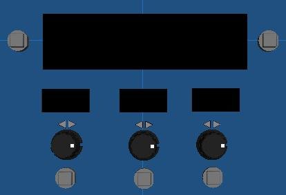

Hi guys,
Just wondering if it is possible to reuse bitmaps for more than one GLCD Object. Our setup has got 4x OLEDs in total driven by PIC32MZ (1x Parallel 8088 SSD1322 and 3x Buffered SSD1306 and we were looking for a way of being more efficient when storing bitmaps in ROM by sharing the same bitmaps amongst the different GLCD objects?
I know this looks more like a request rather than a question, but was wondering if this was easily doable or due to some constrains was really not possible to implement at the moment...
Thanks for your help!!
R
