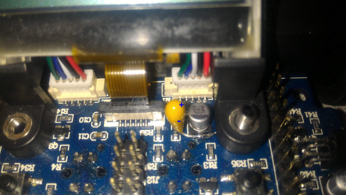

I beleive the cap at fault is C13 and can be confirmed as touching the cap when not working should allow the robot to come to life.
Replacing this with a ceramic 1uF - 10uF 1206 should fix the problem for you.

I just tested 2 repairs on two of my allcode.
The first one was to remove the 10uF smd C13 capacitor; this is very delicate and the tracks are very very fragile! You have to be very well equipped to do the maintenance. I damaged the track and I had to do a strap from the "Vcap" pin of the microcontroller!!!
The second solution is to place a tantalum capacitor of 1uF in parallel with the existing one

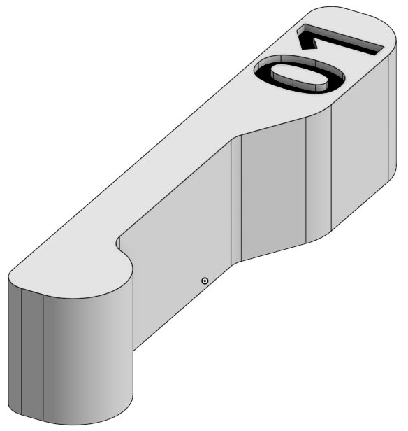

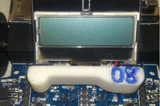

and to place a protection in 3d printing (onshape link: https://cad.onshape.com/documents/5c31a ... ebb788f1a5) on the whole.
