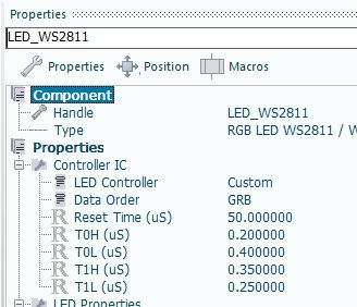

I'm using these timings with a lot of success on a 16-bit PIC device. Please can you have a go.
