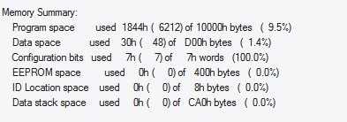

just an update after some time trying different things..
I created 6 LUT droping 6 different components in my project's panel.
I then paste on each table the 4000 values. So in total i have 25000 values in those 6 LUT !
I compile the project and the result of the used space was amazingly vesy small!
:shock:
So now i am almost sure that the memory space is enough for holding the two LUT that i want to have (25000 elements on each table).
Do you think that there is any way of writing 25000 element in one LUT and not seperate the values in quantities of 6000 or less? :roll:
Thanks in advance!

Re: Look Up Table - Size of elements
Post by kersing »
This doesn’t make sense. If you have 4000 elements of 1 byte (let alone a larger integer) you need 4000 memory locations to store those values. None of the memory allocations in your output has 6 times 4000 elements = 24000 elements allocated. My guess is the lookup tables are truncated or the optimizer got rid of them (do you access any elements in your code?)
Post by George_B »
kersing wrote: ↑
Fri Mar 19, 2021 9:36 pm
I thing you are right. In the simulation i can access all the elements of any of 6 LUT. After i checked the C code produced from the compiled project i realized that there are only the elements of the first LUT! The other 5 are mising from the code..
