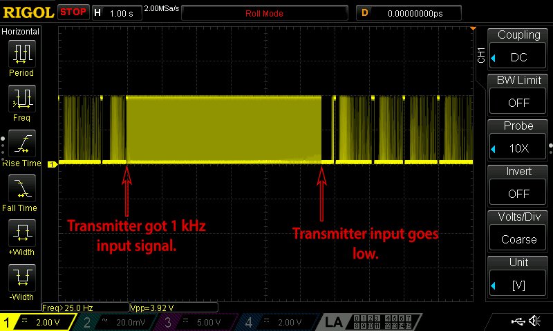

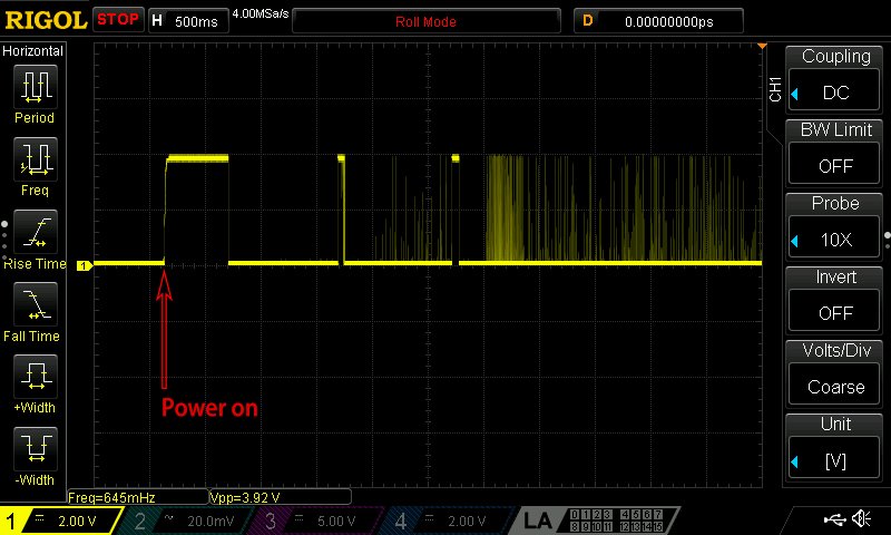

I've tested these RF modules and I can't recommend it. If the transmitter doesn't send any data or the transmitter input is in L state, the receiver output goes crazy.
I have no idea, how they deal with this crazy signal in projects like this: https://randomnerdtutorials.com/rf-433m ... h-arduino/. This random data can push the controller into an interrupt too many times and this can slow down the main program execution. Maybe i'm not smart enough for this. :( I have no time to spend to solve a simple communication problem when it can be instant get.

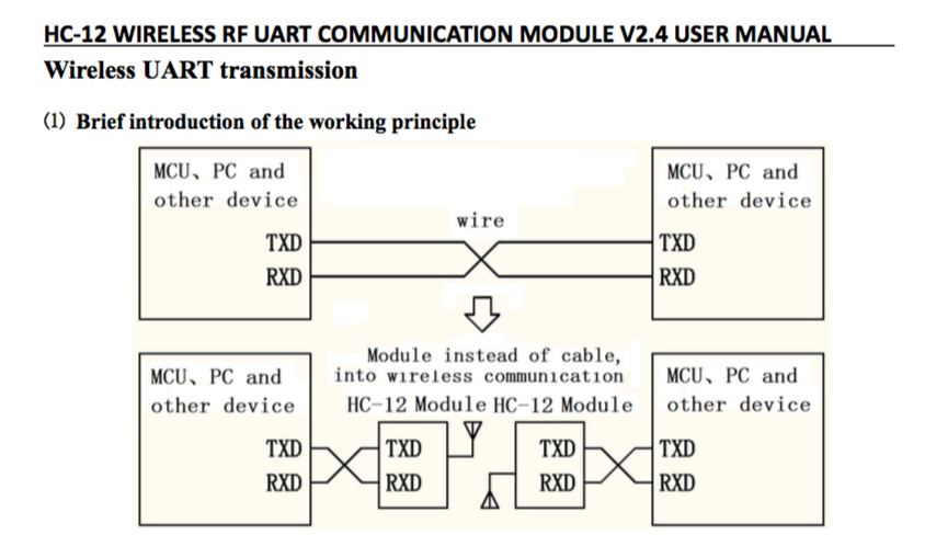

After the first test, i've put away this RF module. APC220 module is very good but expensive. Cheaper alternative (for me) is the HC-12. Both module have UART (RS232) input and output and they can act as a transmitter and receiver. What you send in into one side, it's come out at the other side.

I am agree with Backman. The HC12 module is very good and they you are able to configure them. the best choice.
