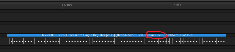

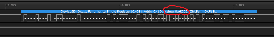

Re: Help regarding compilation error and existing mistakes in my MODBUS programming
Good evening.
Help solve the problem with Modbus RTU.
The master sends the request, the slave receives it correctly and executes it.
The slave sends a response is not correct. (Only the low byte)
- request1.png (11.78 KiB) Viewed 7019 times
- reply1.png (13.03 KiB) Viewed 7019 times
Dear Benj.
Tell me so it should be in Modbus RTU RS485, or is it a bug?
FC 9 components have been updated.
