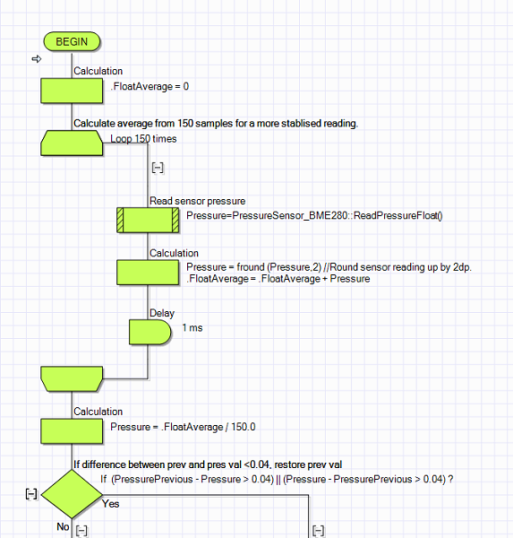

I'm using a BME280 Temperature/Humidity/Pressure Sensor.
So I could calculate altitude, It was vital the pressure float results were ultra-stable.
To do that I used
Very stable readings.png (145.45 KiB) Viewed 3614 times
The altitude was so stable it could measure the height of me lol.
Note: I used ground to keep floats rounded up to 2dp.

thanks for your submission but I think it is not good for my work, I had already done such a thing, if I understand correctly yours is a mathematical average made on 150 samples, and having a loop of 1 mS it can be said that the result that you could theoretically see on a display would be every 150mS, unfortunately my times are much longer as I receive new data only every 200mS so with an average set to 50 I have a new value to send to the display every 10Sec, I would need it a FIFO type average, that when I filled the buffer, I update the oldest data with the new one and recalculate the result, and I would have an update every 200mS
I hope I have understood your example, otherwise correct me
thanks for your help
