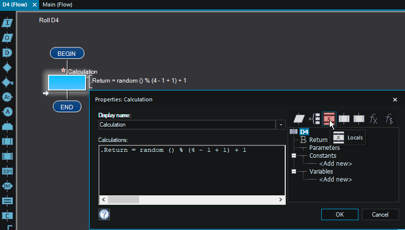

Posts: 9521
Has thanked: 2585 times
Been thanked: 3815 times
Re: DND dice roller
That is because you are calling a user macro (D4) and expecting a return value.
Within the call user macro, you must specify
.Return
The
means it's a local variable.
Just select the Locals icon and drag
Return
or just type it in.
Your calculation should look like this:
Use Return.png (41.34 KiB) Viewed 4510 times

Post by BellDynJinn »
medelec35 wrote:
Wed Nov 24, 2021 2:53 pm
.Return
The
Return
or just type it in.
Your calculation should look like this:Use Return.png
that seems to be working now thank you
