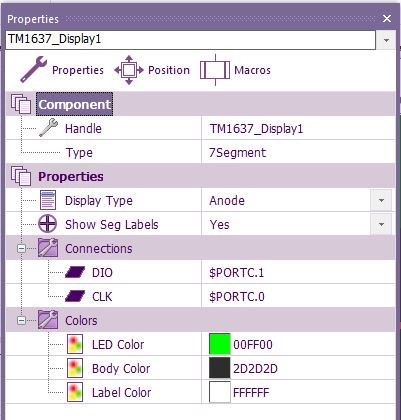

Thanks for thinking along Martin. Well i have a project in an ATMEGA328P(B) where data is read from an external data stream. This proces happens a 1 to 20 times a second.
The outcome is put in an single led BCD display. The 7 led Cathodes are direct fed to outputs. The common Anode is fed from an PWM channel output in the same processor. Fortunately the pwm signal output is not influenced by the loop timings 8) .
There are no downeffects seen of an active signal in the loop or bypass. (varing loop timings)
Now i changed the number of displays to total 4 in parallel and the anodes are fed from 4 separate outputs sequencing on off at the end of each loop. Because the loops are varying in run time the displays are not evenly lit up. i think in the old days they used an external shift register or so for this...
for now im stuck :wink:
i found a very simple 4 digit display with TM1637h but only 'arduino' librarys :roll:
Posts: 786
Joined: Fri Jun 06, 2014 3:53 pm
Has thanked: 187 times
Been thanked: 205 times
Re: using Arduino Library
Post by chipfryer27 »
If I remember correctly the TM1637 uses a two wire communications protocol that is a bit like I2C, but isn't.
Flowcode v9 does support displays using that chip though.

Post by Dutch »
chipfryer27 wrote:
Thu Jan 19, 2023 10:37 am
Good find Chipfryer! thank you!!! its an excuse now to upgrade to FC9 :mrgreen: :wink:. what i would have eventually done anyway to support the developpers.
