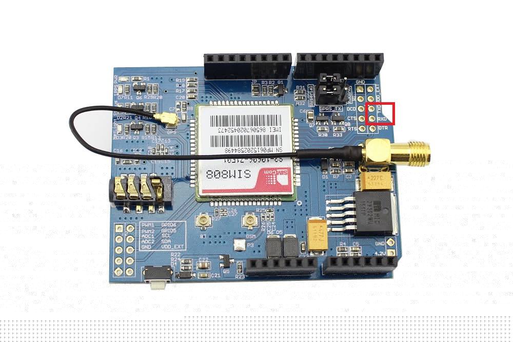

Hi guys im new here and im currently working a project that uses a pic16f877a microcontroller. Im just wondering if i can use the gsm component in flowcode. This is the module that i use Elecrow SIM808.

My guess would be that it would be possible as it seems that your module has RX and TX connections (UART) and it should send NEMA messages which the FC component can decode
Hook it up and give it a go

NEMA? - Judging by the picture its GSM module onboard is SIMCom SIM808, so standard AT commands are the controlling messages.QMESAR wrote: it should send NEMA messages which the FC component can decode
The full list of commands can be downloaded on the SIMCom site when scrolling product page down.
NMEA is GPS protocol... and there is a application example about that on the datasheet page 52.
But the Flowcode included GSM component should be able to handle this module. Just wanted to clarify its AT, not NEMA commands.

So i tested it and it did not work. I first tried using the command on the gsm CheckNetworkStatus and if it is connected it would send a value of 1 and 255 if no connection. Sadly i got 255. This is the sample flowcode that i use in testing it.

How are you powering the module. Are you using a Lipo cell battery or a DC PSU? If using a PSU then what voltage and current is it rated at?
The SIM808 module requires an input supply voltage of 3.4 - 4.4V and a current capability of 2A.
Also the PIC and GSM board will need a common ground, e.g. a wire connecting the VSS pin on the PIC and Ground pin on the GSM board.
Depending on the voltage of your microcontroller you may also need a potential divider on the TX pin to reduce the voltage from 5V to more like 3V.
This topic may help.
