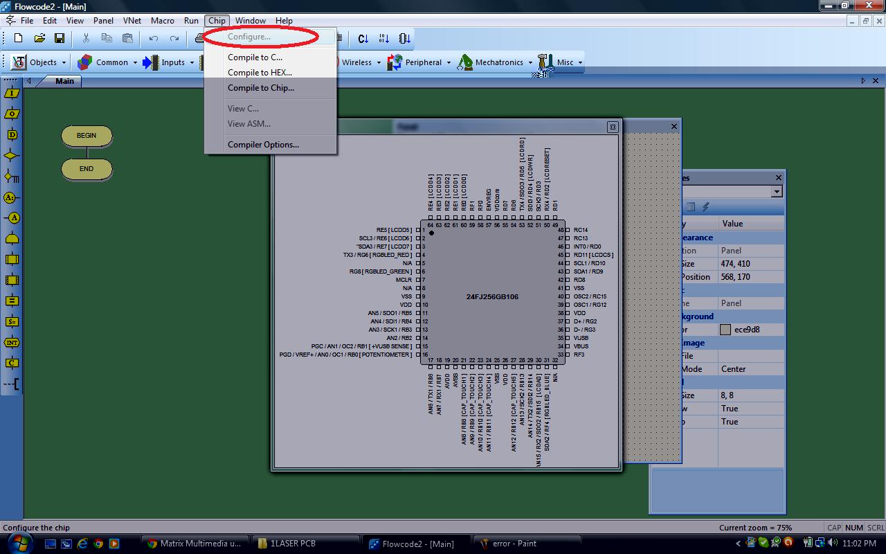

problem in chip selection fcd for ds pic
Post by greentech »
Hi there,
I just bought fcd for ds pic. the problem is, when i click chip / configure it gives an error unrecognized chip on command line.
when i click ok it takes me further to the pic configuration window where when i select chip it says unable to create microcontroller dspic33------ as the definition file. dsPIC33------ is missin or corrupt.
can u xplain me what to do.
best regards.
Ismi
Re: GSM E Block
Hello Ismi,
Can you tell me which device you have selected for your target and I will see if I can replicate your problem.

Re: GSM E Block
Post by greentech »
Hi there,
Sorry for replying late ive been away for a while.
benj it doesnt matter what chip i am using. any chip i try to load gives me an error message..... i am attaching some pictures.
i also found flow code was unable to compile the rf component.

the chip selector is frozen when i select starter package.
(141.83 KiB) Downloaded 5709 times
(154.33 KiB) Downloaded 5709 times

Flowcode does not support the dsPIC30F2022 device, and I can't find a reference for it as a current device on Microchip's site.
I have not looked at the specific GSM compilation error. Can you please post the FCF and the C code file that is created by Flowcode for this project and we'll look into it for you.

this is not even loading 30f2020 which is supported according to the datasheet, can u provide me with the fix?
