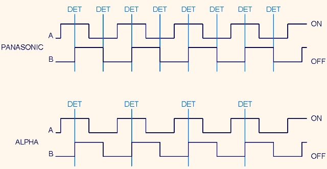

I was busy 3 days ago with rotary encoders like you. The difference is that i experiment with detent equiped encoders, an ALPS a BOURNS and a Panasonic. As for the rest i also use a P16F88 and instead LCD i use the Led board. Until now, i haven't managed to use the PORT interrupt. Detent equiped encoders (used mostly in audio devices) present two different paterns. I attach a picture, the upper patern is that of ALPS and BOURNS while the lower pattern is that of Panasonic. The vertical blue lines are the detent positions, the red area is the debounce space offered by ALPS and BOURNS (bounce is reffered as "Chatter" in encoders). The difference is that both A and B outputs of ALPS in detent position are LOW, while A output of Panasonic can be either HI or LOW in each detent position and its B output is not deffined because its transition edge is exactly placed on detent position. For this reason, different code needed for ALPS-BOURNS and different for Panasonic (many other constructors also use the Panasonic pattern). I followed the same way like you in software, PIC reads the A output as a transition event while the B output as direction.
I attach the two fcf files, both are tested and working on actual hardware. Common terminal "C" of encoder must be connected at +V. You can test them and i think that your encoder can run both versions as it is not detent equiped. If you have any idea of what i can do to use the PORT interrupt i will appreciate it. I will try your program tomorrow on actual hardware, it is very interesting.

Just now i tried your project on EB006 with the ALPS encoder. In general is working as you described. There are some issues due to detents of encoder:
1) The counter increments or decrements by "2" (e.g. 2-4-6-8..... 24-22-20-18....) and that is correct for this type of encoder.
2) There is "Chattering"; if the encoder is fast turned and stopped in a detent position enough times shows odd numbers (e.g. 13, 25, 33 etc.) .
I must clear out, that the project of Martin will be working perfectly with the use of continuous turning encoders like that he used to develop his program
Fotis

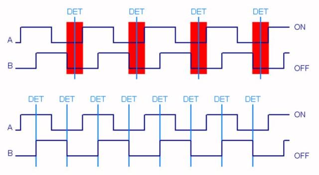

I have good news. Early the morning (when the mind is clear) i resolved the problem of PORT interrupt. The problem finaly wasn't the debounce time of 5ms, it was the lack of a variable and a decision. I attach both new fcf which i tried with success on actual hardware. The PORT interrupt is enabled, the delay of 5ms still exists, and the encoder run the LEDs in crazy speed without errors. I tried everything to cause errors, crazy rotation, steep change of turn direction, stop in the middle of detents etc. the program responds positively without mistakes in any abuse. Few words about rotary encoders for the newcomers on this thread:
In the picture you can see the patterns produced by different types. In my examples i use encoders with detents, while Martin in his example use a continuous rotation encoder. In audio and multimedia devices detent encoders (most times equiped with push-switch) are prefered because they stay immobile when are not operated. That is of big importance when they execute other operations except volume control like input selection. In other audio devices - like pro-CD players - continuous rotation encoders are used for JOG - DIAL operations; in measuring instruments and medical devices this type is also used. It is upon the demands of device. Any type of encoder produces these patterns
Continuous encoders present just bounces, while detent encoders produce chatter due to detents and bounce due to switches. In addition, detent encoders offer different patterns combining detent positions and switches state. Therefore, different code is needed for each type. The 3 terminals of encoder (A, B and C=Common) may have different place from type to type. Both ALPS and Panasonic that i use in my examples have same terminal arangement. Common at the middle, B at the left and A at the right of C. Martin uses internal pull-ups of P16F88 and has the C terminal connected to Gnd node. Me i use external pull-down resistors - exactly like in the EB007 switch board - so Common terminal is tied at +V. You can run both fcf in simulator, but you could not see the game live. You have to buy Panasonic and ALPS or BOURNS detent encoders to make your experiment. I stoped purchases from Farnell UK, DigiKey, Mouser etc. as they charge an arm and a leg to ship worldwide (Greece included) and i search on e-bay for parts. Here is a good source for Panasonic: http://cgi.ebay.co.uk/ws/eBayISAPI.dll? ... K:MEWAX:IT and here for ALPS: http://cgi.ebay.co.uk/ws/eBayISAPI.dll? ... K:MEWAX:IT. Of course not for you that you live in UK.

Sincerely i believe you, your thought is very logic. But the facts... I tried again and again, two times each fcf, with or without delays. I can confirm you that it hapens the inverse: if i remove the 5ms delays, then the program on actual hardware is not working, is absolutelly dead. When i place again the delays, the program runs correctly on actual hardware, without error, corruption, hang-up etc.
Some details: I haven't activated the internal weak pull-ups of P16F88, i use external pull-down resistors tied at pins RB.6-RB.7, the Com terminal of encoder is tied thru a 390Ω resistor at +V supply rail. But i think that does not matters. Also, oscillator frequency is 4MHz.
It is probably a mechanical issue, owed to the detents of encoder. I remember that i placed these delays by reading carefully datasheets. Panasonic and ALPS encoders, both have a chattering time of 5ms max. Chattering is the time interval between a detent position and a switch activation, in which is also included the bounce time of switch. In the diagram i posted above, the red areas indicate this time interval.
ALPS recomends that this interval should be masked to avoid chattering phenomena. I hope i gave you an idea.

I hope this can help you a little. In the attached picture, you can see both patterns of Panasonic and Alpha encoder in CW direction.

Your more an expert with encoders than I am, since the day of my initial post was the 1st time I have played with encoders. I do find the topic interesting though.
The other puzzling thing when comparing Panasonic with alpha, is the waveforms look identical ,but DET is different.
Isn't the DET base on how you set the flowchart up, since A and B are only on/off switches.
If Panasonic is DET on leading and falling edges, then why can't same apply to alpha since has same leading an falling edges of Panasonic? Also its all the changing edges that will trigger some,and not 1/2 of them as shown on alpha.
@ John Odd its the opposite, since the waveform of all three types look identical ie B lags A when rotated clockwise. I have deliberately placed coding within interrupt so count does not roll over or under.
