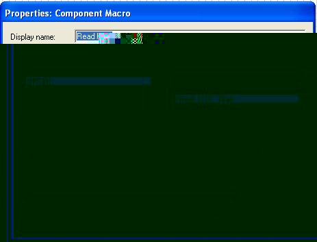

When I look in the properties of component macro, I see at the variables tab a `h` but can not find a `h` in variables but of course return value hour is in variable.
Can someone explain what 'h `refer to. the same for minutes, seconds, etc.

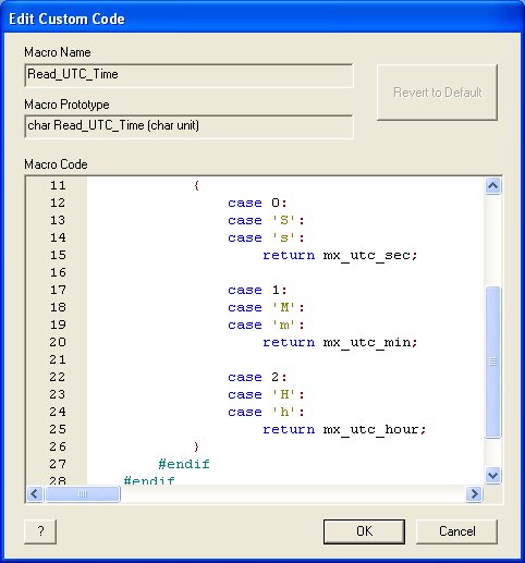

If you look at the custom code for the GPS component, hi-light Read_UTC_Time and click edit code you will getting the following
you will see that the macro returns a type char (in this situation it is used as a byte to return the required data) and that it takes a char type (unit), this is where the 'h' comes in. From the custom code you can see that it returns the data that is requested based on the value of unit.
For hours, then ‘h’, ‘H’ and 2
For minutes ‘m’, ‘M’ and 1
For seconds ‘s’, ‘S’ and 0
A similiar procedure is used for the Read_UTC_Date macro as well.

To find custom code, right click on the GPS component (the compass) and you will see custom code.
The macros that are available are shown, these are also the ones that are shown in the Component Macro once you have selected GPS(0) as the component.
Component Macro.jpg (30 KiB) Viewed 4503 times
I have modified the example GPS and attached it. It alternates between time and position every 1 second. Hopefully this will point you in the right direction :D
