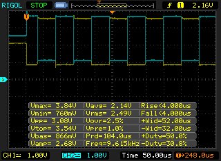

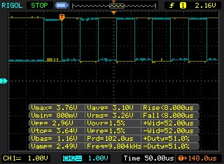

Right here it is Have not touched settings on the scope for easier comparison. One is SP485 and the other DS75176 same termination. Both using the same flowcode routine sending 0b01010101, 19200 8bit 1stop no parity
