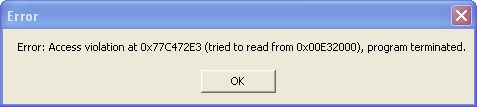

I have just had to reload the operating system on my pc and all apps including Flowcode, after I had done this I proceeded to program a chip which
I am using in a project at the moment, when the Linker/Assembler starts it gives me the following Error:
I am using Flowcode version 5.5.2.1.
Does anybody know what this could be please ?

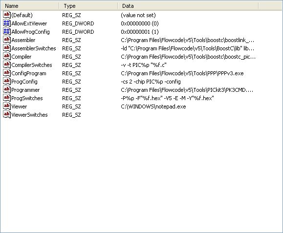

Re: Flowcode Programming Error !
If you open the compiler options select the linker tab and check both boxes are as follows, just copy and paste into the boxes depending on your version of windows
64Bit
Location
C:\Program Files (x86)\Flowcode\v5\Tools\boostc\boostlink_pic.exe
Parametrers
-ld "C:\Program Files (x86)\Flowcode\v5\Tools\BoostC\lib" libc.pic16.lib rand.pic16.lib float.pic16.lib "%f.obj" -t PIC%p -d "%d" -p "%f"
32Bit
Location
C:\Program Files\Flowcode\v5\Tools\boostc\boostlink_pic.exe
Parametrers
-ld "C:\Program Files\Flowcode\v5\Tools\BoostC\lib" libc.pic16.lib rand.pic16.lib float.pic16.lib "%f.obj" -t PIC%p -d "%d" -p "%f"

You can delete Flowcode entries from:
LOCAL_MACHINE\SOFTWARE\MatrixMM\FlowCodeV5
Please be careful when deleting from the registry.
Delete wrong entries and you can prevent windows from loading.
To make sure, after uninstall process has finished, you could manually delete Flowcode from C:\Program Files (x86)\Flowcode\v5 (if 64 bit windows)
After you have re-installed, as a good measure:
After running Flowcode, click on Build, Compiler options. Then Click on the down arrow (option list:) and select Default.
A a last resort, change the language of Flowcode to English (View, Global options, Application Tab, Select override language as English.)
Or just try installing as English, as on rare conditions selecting English has been known to stop the error.

I have just tried creating Hex file and the same error message comes up, does anybody know if the memory error message is referring to my laptops memory.
As you just reinstalled everything you might have installed in a different order resulting in a software conflict. You mentioned suspecting hardware, doing another install (OS first Flowcode next, before patches, if it runs add everything else step by step checking FC after each install) to check if it solves your problem is probably cheap compared to replacing hardware.
Hi Fellas,
This problem has just disappeared by itself, I think I know what has happened, because the version of Windows XP on my recovery disc is only service pack 2, my machine uses Automatic Downloads in the background to upgrade to service pack 3, I have just turned on my laptop and it said it was installing updates, after this I tried Flowcode and it worked perfectly, so I guess in Windows XP's case you must make sure that service pack 3 is fully installed before you can use Flowcode.
thanks
Acestu
thanks
