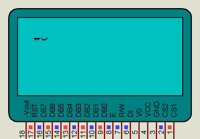

been playing with ks0108 since 9 today.with very strange results, tried delays from 0 to 100( in 1's) no joy, what appears to be happening is it seems to blank out random lines, also i tried to print the following
But what i actually got on my glcd was this (sorry no pic(lost camera) had to mock it up in flowcode)
it's as if it on a vertical line it plots the last pixel on a page. and also seems to print the first and last horizontal lines of a page and just the first pixel of the following lines

Nearly recovered from the office move now and things starting to appear back out of boxes. I have a EB006 and the display so I will rig it up tomorrow and see if I can get anywhere.

I have got the hardware rigged up now but so far have been unable to get anything from the display. I'll keep on with it for now but it could be my display has become damaged, also could just be my micro.
Edit: working now - had shorted some of the bus pins together! I'm now getting the same graphical corruption on the text so let me see what I can do.

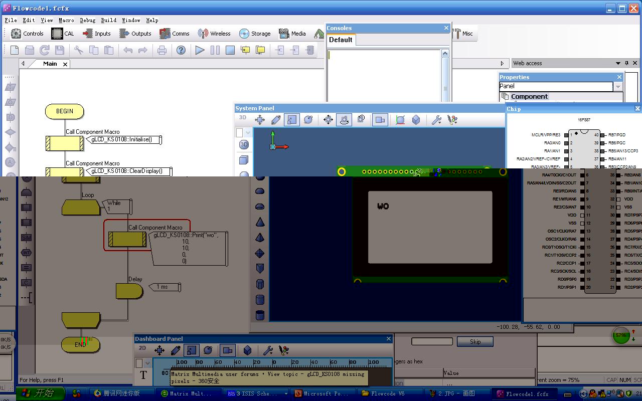

Do have a problem.
I in the proteus simulation is also the same problem.
The following is a screenshot:
(151.68 KiB) Downloaded 2749 times
