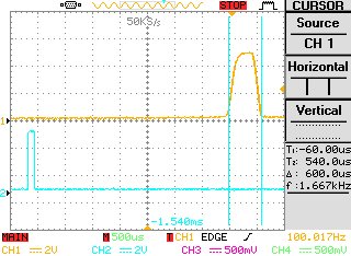

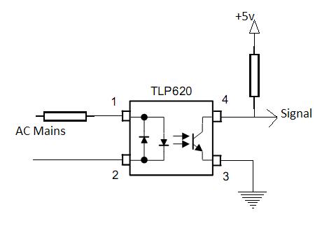

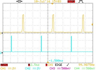

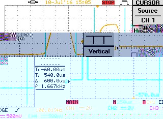

For zero detection I'm using a TLP620 like picture below, in my case with 2k2 resistor to 24Vac and the other side a 10k resistor connected to RB0 and 5V that gives a pulse about 600us. Also some oscilloscope screens shots
Phase = x * 7 / 10 + 74 i have an idea but can you please explain?

now the screen shots...
ch1 yellow - zerocrossing at RB0
ch2 blue - pulse out
